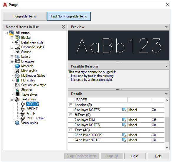

Two views are available at the top of the Purge dialog box:
Lists the items in your current drawing that you can purge in the tree view pane on the left side. Additional items can be removed from the drawing under the Purge Unnamed Objects pane on the right side of the dialog box.
Lists the named objects that are not used in the current drawing and that are purgeable. You can list the items for any object type by clicking the plus sign or by double-clicking the object type. You can either select an individual item or all the items of that object type.
Displays a preview of the item you selected in the tree view by clicking on its name.
Displays the Confirm Purge dialog box when you purge an item.
Removes all unused named objects from the drawing even if they are contained within or referenced by other unused named objects.
Deletes geometry of zero length, including lines, arcs, circles, and polylines.
Deletes mtext and text objects that contain only spaces without any text.
Performs a drawing scan and removes obsolete DGN linestyle data when you open the Purge dialog box.
Removes the selected items from the current drawing.
Purges all unused items.

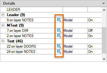

Preview objects that you can't purge and find those objects in your drawing.
Lists the named objects that are used in the current drawing and can't be purged.
Most of these objects are currently used in the drawing or are default items that can't be removed. When you select individual named objects, information about why you can't purge the item is displayed.
Displays information about why you can't purge the selected item.
