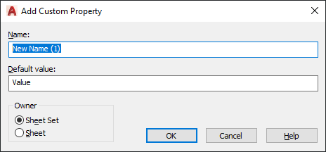

Creates a custom property to be associated with the current sheet set or with each sheet.
SHEETSET (Command) Find:
Custom properties can be used to store information such as a contract number, the name of the designer, and the release date.
The following options are displayed.
Specifies the name of a new custom property.
Specifies a value for the custom property.
Specifies whether the custom property belongs to the sheet set or to a sheet.
