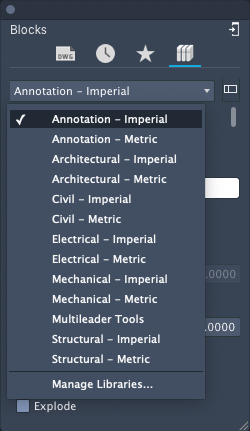

  • Displays the blocks in the current drawing.
  • Displays recently inserted or created blocks. The recent list persists across drawings and sessions.
    Note: The name of an external file that's inserted as a block includes an asterisk (*) in the Blocks palette.
  • Displays the blocks that you have selected as favorites from the Blocks list.
  • Displays the blocks from a selected block library. Select the library from the drop-down.

  • Manage Libraries - Displays the Manage Content Libraries dialog box in which you create and manage content of libraries.
    Note: You can also select the Manage Libraries icon next to the library drop-down list to display the dialog box.
