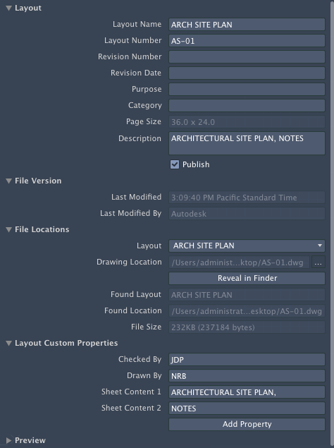

Displays information that is specific to the selected layout, such as the name, number, and whether it will be included in publishing operations. Also displays custom properties, if any.

The following options are displayed.
Layout
Displays information used to identify the layout in the project.
Layout Name
Displays the name of the layout in the project.
Layout Number
Displays the number for the layout.
Revision Number
Displays the revision number assigned to the layout.
Revision Date
Displays the revision date for the layout.
Purpose
Displays what the layout is used for.
Category
Displays the name of the category the layout.
Page Size
Displays the page size for the layout.
Description
Displays the description for the layout.
Publish
Controls whether the layout is added to the Batch Publish dialog box when publishing a group or all layouts in the project.
File Version
Lists information about the associated drawing (DWG) file.
Last Modified
Displays the date when the file was last modified.
Last Modified By
Displays the name of the user who made the last modification to the file.
File Locations
Displays the location of the drawing file that contains the project layout.
Layout
Specifies which named layout in the drawing (DWG) file that should be associated with the layout in the project.
The drawing (DWG) file that contains the layout is specified in the Drawing Location property.
Drawing Location
Specifies the path to and the drawing (DWG) file name where the layout was previously saved.
Reveal in Finder
Opens Finder to the location of the drawing (DWG) file associated with the layout.
Found Layout
Displays the name of the layout in the drawing (DWG) file associated with the layout in the project.
Found Location
Displays the path and file name of the drawing where the layout was found.
File Size
Displays the size of the drawing (DWG) file associated with the layout.
Layout Custom Properties
Displays the user-defined custom properties associated with each layout in the project.
You can manage user-defined custom properties by:
  • Clicking Add Property to display the Add Custom Property dialog box and create a new property.
  • Right-clicking over a property and choosing Remove Custom Property to remove the property.
    You can also choose New Custom Property to display the Add Custom Property dialog box and create a new property.
Preview
Displays a preview image of the selected layout.
