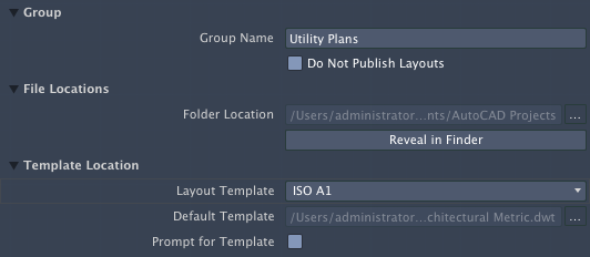

Group Properties (Project Manager)
Displays information that is specific to the selected group.
SHEETSET (Command)
Menu: Window > Project Manager: Select a group in Project Manager
List of Options
The following options are displayed.
Group
Displays the name and if the group is included when publishing.
Group Name
Displays the name of the group.
Do Not Publish Layouts
Controls whether the layouts in the group are added to the Batch Publish dialog box when publishing the group or all layouts in the project.
File Locations
Displays information about the folder on disk that the group represents in the project.
Folder Location
Specifies the folder location for new drawing (DWG) files created as a result of adding a new layout to the group.
Does not impact the folder location of a drawing (DWG) file when adding layouts from an existing drawing.
Reveal in Finder
Displays the resolved absolute path to the folder on disk that the group represents.
Template Location
Displays settings used when creating a new layout in the group.
Layout Template
Displays the layout to use when creating a new layout.
The layouts displayed in the drop-down list come from the file specified in the Default Template property.
Default Template
Specifies the drawing template (DWT) or drawing (DWG) file to use when creating new drawing files for the project.
Prompt for Template
Controls whether the New Project Layout dialog box is displayed in the expanded or collapsed state each time a new layout is added.
