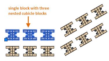

- One or more block definitions created in your
current drawing. For example, you might want to create a block from a set of objects that appear repeatedly in that drawing, such as the following cubicle arrangement that contains multiple
nested blocks. All the blocks used in the cubicle arrangement can be combined into a
single block for multiple placements.

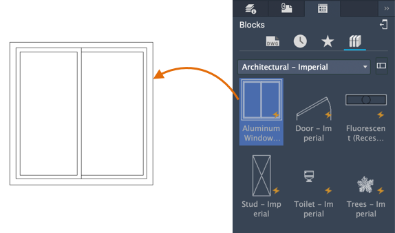

Insert a Block
The Blocks palette is used to insert blocks.
- Click
This opens the Blocks palette and makes it active. By default it is docked on the right-side of the application.
Display Options Toolbar
Displays the blocks in the current drawing.
Displays recently inserted or created blocks. The recent list persists across drawings and sessions.
Displays the blocks that you have selected as favorites from the Blocks list.

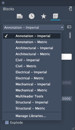

Displays the blocks from a selected block library. Select the library from the drop-down.
- Select the display option for block libraries.
Each of these block libraries contain a set of related block definitions.
- Select a block library that interests you.
- From the Blocks palette, double-click to place the block, or drag to place it. When you double-click to place the block you can use object snaps for more precision.
