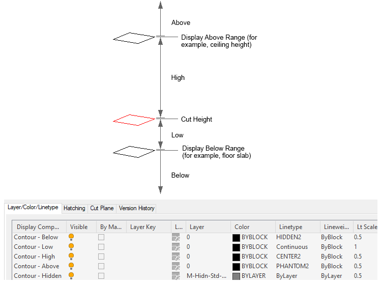

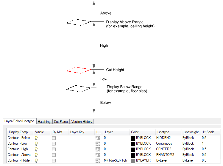

The cut plane is the height at which an object is cut to produce the plan representation.

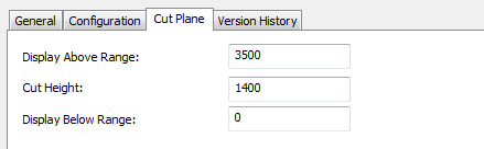

Example of Cut plane tab in the Display Manager
The values you enter for the Above and Below ranges are not relative to the cut height. They are absolute height values calculated from the WCS origin. Therefore, the value that you enter for Display Above Range must be greater than the value that you enter for Cut Height. Invalid values will produce incorrect results.
Objects above this range are displayed using the Above display components. For example, in 1-line display representations, this is the Single Line - Above component. In plan display representations, these are the Contour - Above, Insulation - Above, and Rise Drop - Above components.
Objects at or below this range, but above the cut height, are displayed using the High display components.
