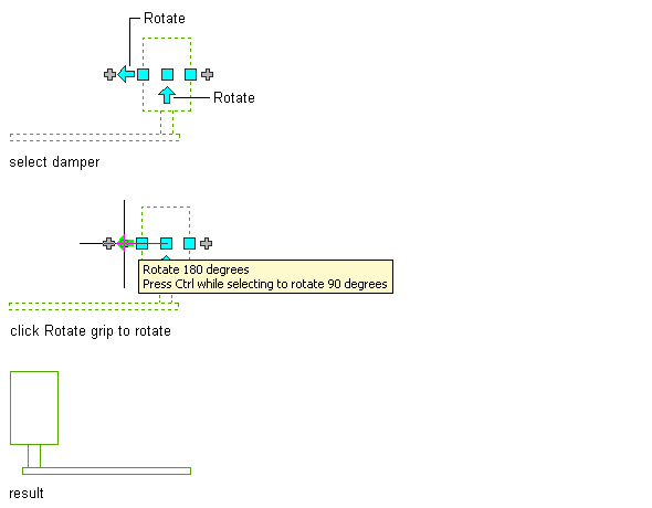

You can use the arrow-shaped (  ) Rotate grip to rotate HVAC in-line parts, duct fittings, and takeoffs 180 or 90 degrees in the direction indicated by the grip.
Remember: For more information, see Rotating Duct Components.
Rotating a damper 180 degrees in plan view

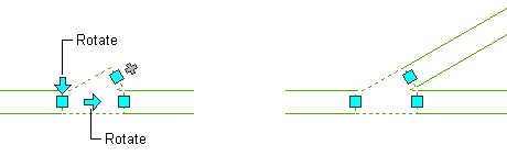

AutoCAD MEP 2021 toolset displays Rotate grips on all HVAC in-line parts, fittings, and takeoffs with connectors on opposite ends. However, when necessary to preserve the connectivity of duct runs, the software limits the available rotation options or hides the grips. For example, in the following illustration, you can rotate the wye fitting on the left in several ways, but you cannot rotate the wye fitting on the right due to the connected branch.
Wye fitting with Rotate grips and another without
