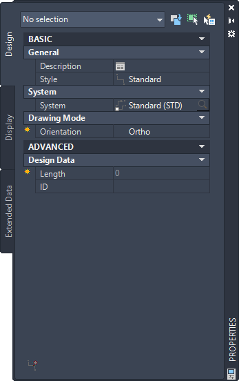

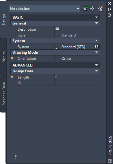

  2. Expand Basic, and for Description, click , enter a description for the schematic line, and click OK.
  3. For Style, select a schematic line style.
    You can select from the styles in the current drawing.
  4. If you want to change the current system, for System, select the system to which the schematic line belongs.
    You can select from the systems in the current drawing.
    Tip: You can create schematic line tools that reference styles and systems in content libraries (DWG files).
  5. For Orientation, select Ortho.
  6. Expand Advanced, and for ID, select or enter an ID designation.
    The currently selected schematic line style determines the list of available IDs.
