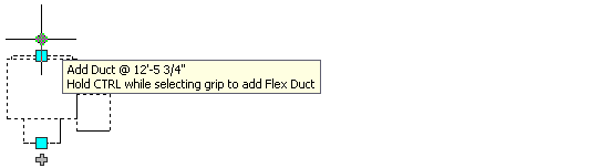

| draw duct directly from an MvPart | select the MvPart and click the Add grip for the connection where you want to draw. ![]() |

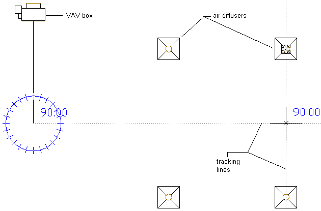

Drawing 1-line duct, top view

You can use AutoCAD MEP 2021 toolset snaps to draw new branches on duct segments. You can also use Add grip on MvParts, ducts, and duct fittings to create new runs.
Top view of a simple 1-line system: A VAV box is connected to 4 air diffusers.
