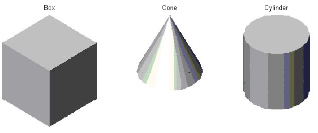

Primitives are limited versions of part models that are designed for repeated use in part creation. They represent basic shapes, such as a box or a torus, and commonly used connections on parts, such as a flanged pipe connector or duct connector.
Primitives that represent basic shapes

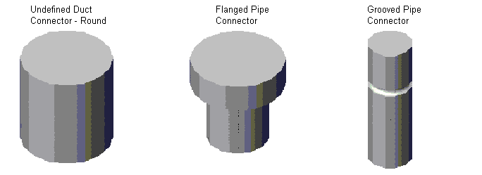

Primitives that represent part connections
Primitives include the following modeling features:
Primitives that represent the connections on parts also include defined connections.
