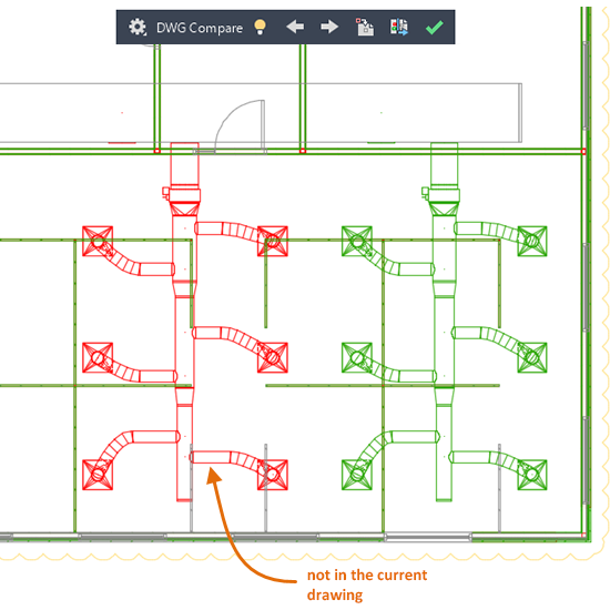

DWG Compare Import
You can now import
AutoCAD MEP objects that show up as differences after comparing between 2 drawings.
You can import the highlighted differences (red) from the compared drawing into the current drawing. If you do so, these objects will now exist in both drawings and will automatically turn gray. Only the objects that are not in the current drawing can be imported.
