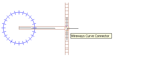

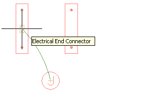

Like all AutoCAD MEP 2021 toolset snaps, electrical snaps and wire ways snaps have 2 subtypes:
Wiring a junction box to a light with electrical snaps
Connecting one cable tray to another with wire ways snaps
