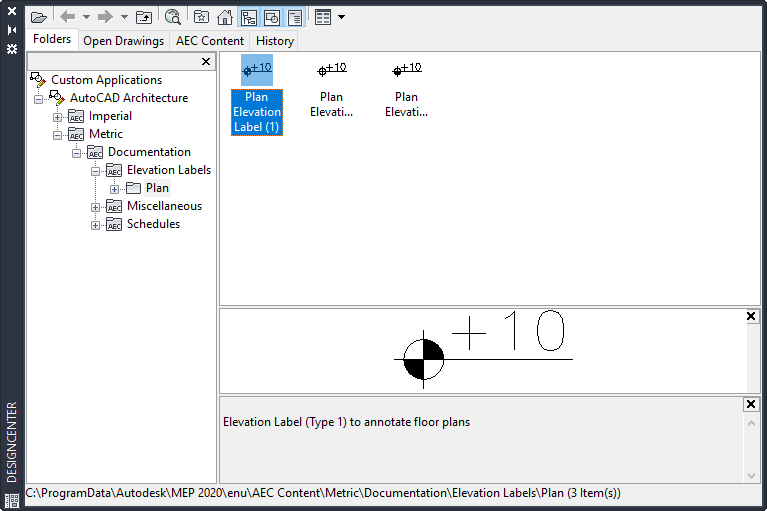

To create a tool from AEC Content in DesignCenter
  1. Click Home tabBuild panelTools drop-downTools
  2. Open the tool palette where you will create the new tool.
  3. Click Insert tab Content panel Content drop-down Design Center .
  4. In the DesignCenter, click the AEC Content tab, and navigate to the AEC Content item where you can choose the tool to create.
  5. Drag the item to the tool palette.
    The software inserts a new tool on the tool palette.
  6. Define additional properties for the new tool, if necessary.
