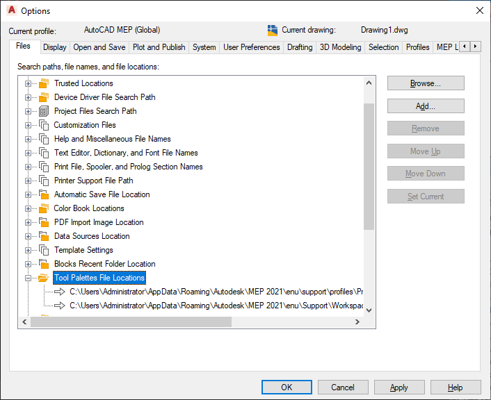

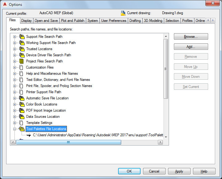

The tool palette set is the collection of tool palettes specified for the current profile in the Tool Palettes File Locations setting.
If the tool palette set contains a large number of tool palettes, you can create tool palette groups for the current profile and organize the palettes in the tool palette set inside the groups. This enables you to display either all of the palettes in the tool palette set or only those in a single group, switching between tool palette groups as needed. The profiles included with the software define several tool palette groups for the tool palettes, including HVAC, Piping, Electrical, Plumbing, Schematic, and Architectural.
If you are working in a project, the tool palette set also includes a tool palette group for the project. When you set a project as current, the software appends the AutoCADTool Catalog (ATC) file location for the project-specific tool palettes to the path for the tool palette set. When you close the current project or set another one as current, it removes the project-specific tool palettes from the path.
