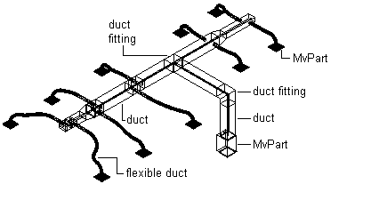

Parts of a mechanical system

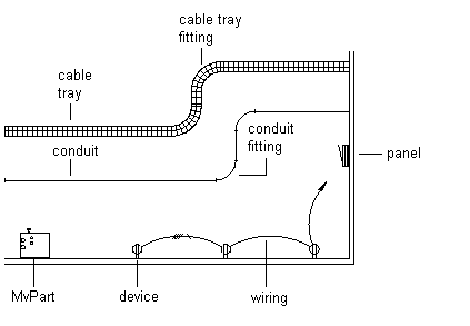

Parts of an electrical system

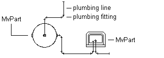

Parts of a plumbing system
