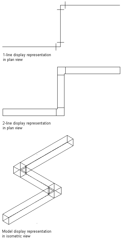

Most AutoCAD MEP 2021 toolset objects have 1 Line, 2 Line, Model, and Plan display representations. This is because these are the most common design scenarios that require different views of a building system.
Some building systems objects, such as label curve objects and schematic objects, have only a general display representation because the display of these objects does not change in different views.
