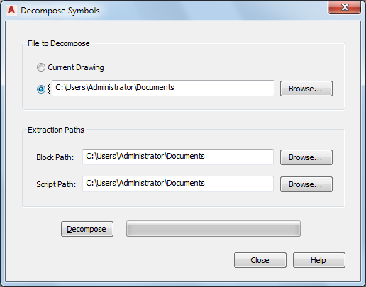

  1. Click Manage tab MEP Content panel Decompose Symbols .
  2. In the Decompose Symbols dialog box, for File to Decompose, select the drawing (DWG file) that contains the schematic symbol styles to convert:

  3. For Block Path, click Browse, and select the folder in which to place the drawings that contain the AutoCAD blocks used by the views in the schematic symbol styles. Click OK.

  4. For Script Path, click Browse, and select the file name of the symbol conversion script to create:

  5. Click Decompose.
    The software converts the schematic symbol styles into the blocks used by the style views and generates an associated script based on the style definitions.
