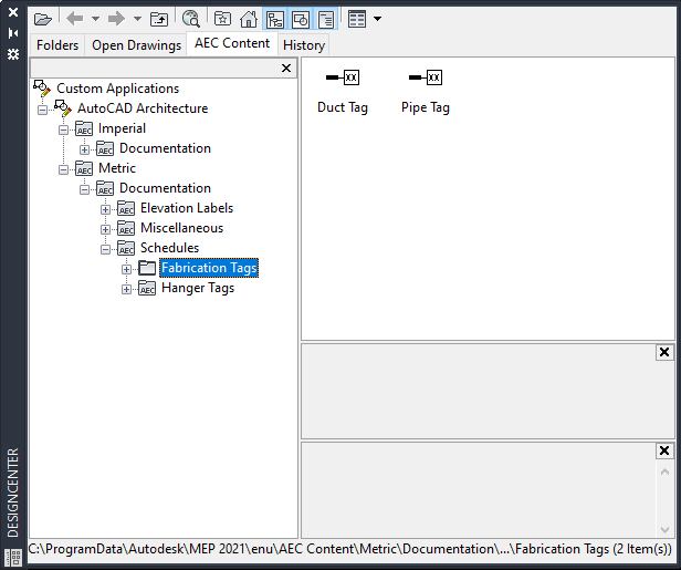

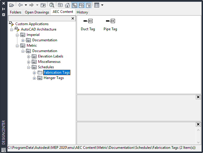

  1. Click Insert tabContent panel drop-down Design Center.
  2. On the DesignCenter palette, click the AEC Content tab.
  3. Under Custom Applications, expand AutoCAD Architecture 2021 toolset, and then expand the directory for the desired units (imperial or metric).
  4. Expand the Design or Documentation directories, and continue expanding subdirectories.
    When you select a subcategory that contains annotation symbols, the symbols are displayed in the right pane.
  5. Drag the symbol from the right pane of DesignCenter into your drawing.
