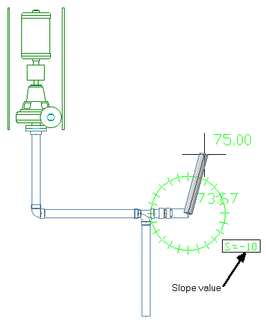

The software displays the current slope value of a pipe segment as you draw the run. Slope value appears in both constrained layouts (pipe drawn between 2 existing pipe objects) and unconstrained layouts (pipe drawn from a pipe object to a point in space). This information is especially useful when routing solutions are generated, as illustrated next.
Slope value displayed
A pipe segment can have a slope value specified on the Pipe Properties palette, or it can have a different slope depending on a particular routing solution that is used. The immediate visual indicator tells you exactly what solution is used and the associated slope value. To turn off this feature, enter PIPESLOPEDISPLAY on the command line. Then enter n at the next prompt.
