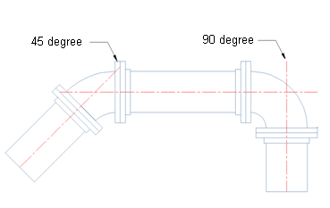

The following example shows a straight centerline of elbows on a pipe in 2-line display. One elbow is 45 degrees and the other is 90 degrees.
Straight centerline on pipe in 2-line display
