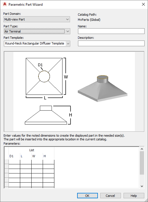

To create a parametric part using the Parametric Part Wizard
Build panel
Tools drop-down
Parametric Part Wizard..
You specify a catalog for a domain in the Options dialog box. For more information, see Specifying Default Part Catalogs and Style-Based Content Locations.
The part name is used to name the XML file that defines the part. It is also displayed when the part is opened in Content Builder or Catalog Editor.
Users select parts by description in add dialogs and modify dialogs. The description is also used to create the names of the part sizes.

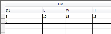

The values are used to create the list of part sizes. To enter a value in a cell, double-click the cell, and then enter the value. To access the Copy, Paste, and Clear commands, right-click the cell.
Example of Parameters showing values for custom round-neck diffuser
Use the prompts provided by the software to guide you in entering the data. For more information about the different types of data storage for size parameters, see Understanding Part Sizes.
The software adds the part to the current catalog, more specifically, to the chapter that corresponds to the part type that you selected. The Add Multi-view Parts dialog box is displayed to add the new part to your drawing, if desired.
