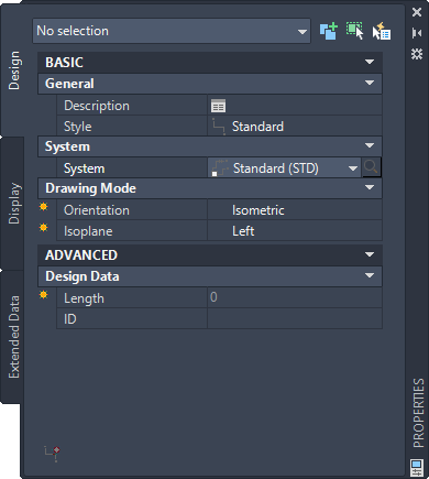

  2. Expand Basic, and for Description, click , enter a description for the schematic line, and click OK.
  3. For Style, select a schematic line style.
    You can select from the styles in the current drawing.
  4. For System, select the system to which the schematic line belongs.
    You can select from the systems in the current drawing.
    Tip: You can create schematic line tools that reference styles and systems in content libraries (DWG files).

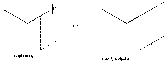

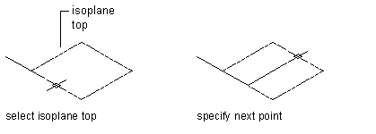

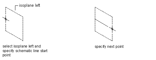

  5. For Orientation, select Isometric.
  6. For Isoplane, select the isoplane on which to start drawing: Left, Top, or Right.
  7. Expand Advanced, and for ID, select or enter an identification label.
    The schematic line style that you select determines the list of available IDs. You can select an ID from the list or enter a different one.
  8. In the drawing, specify the start point for the line, or use schematic AutoCAD MEP 2021 toolset snaps to connect the line to a symbol or another line.
  9. Continue to specify points to draw the schematic line.
  10. To change isoplanes as you draw, on the Properties palette, select a different isoplane for Isoplane, and then continue to specify points to draw the line.
    The UCS icon and crosshairs adjust to the selected isoplane.

Drawing a schematic line on the left isoplane
Drawing a schematic line on the top isometric plane
Drawing a schematic line on the right isometric plane
