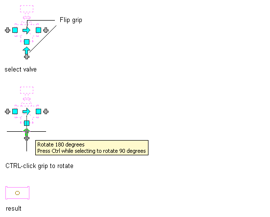

Arrow-shaped (
) flip grips let you rotate piping in-line parts, fittings, and takeoffs 180 or 90 degrees in the direction indicated by the grip.
Rotating a 3-way valve 90 degrees in plan view

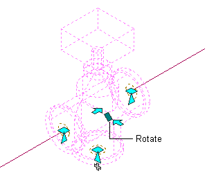

In isometric views, diamond-shaped (
) rotate grips let you rotate the object around its centerline to any angle you specify.
