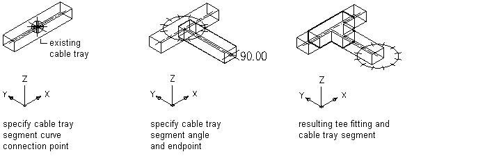

When you start a run at the end of a segment, the nearest valid connection point is not always the endpoint of a segment. You can form a valid connection at any point along the path of another run. In this case, the software inserts an appropriate fitting to connect the 2 runs.

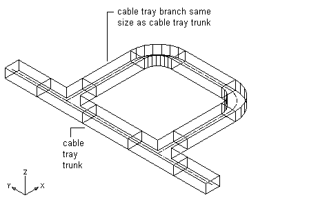

Drawing a branch
Connecting a cable tray run to a cable tray trunk that is the same size

To add a cable tray or conduit branch
  1. Turn on the Wire Ways Curve or Wire Ways Connector snaps.
  2. In the Electrical workspace, click Home tabBuild panelCable Tray or Conduit.
  3. Using the Wire Ways Connector or Wire Ways Curve snap, select the first segment to connect, and then select the second segment.
    You can modify properties on the command line.
  4. Click Close or press Enter to end the command.
