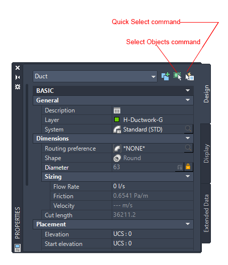

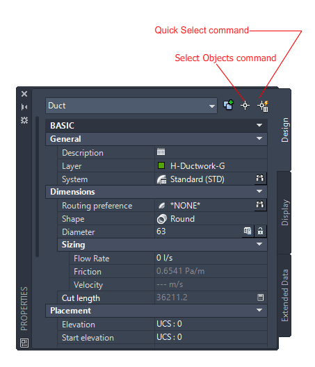

Use icons on the Properties palette:
Select Objects: To create a selection set with your pointing device, for example, by creating a window selection.
Quick Select: To create a selection set filtered by a specific property, such as lineweight.
