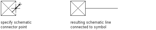

However, schematic lines and symbols are more powerful than AutoCAD lines and objects because they recognize the connection points built into each schematic symbol, enabling you to create an intelligent building system diagram.
Connecting a schematic line to a schematic symbol

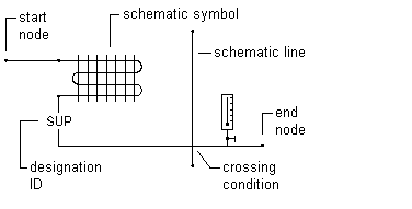

Mechanical schematic line and symbol components

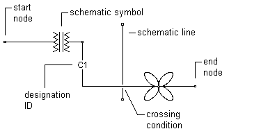

Electrical schematic line and symbol components

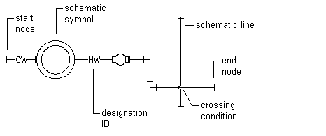

Plumbing schematic line and symbol components
