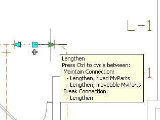

When you use the lengthen grip on an end that is connected to another object, you must specify whether you want AutoCAD MEP 2021 toolset to maintain connectivity between the objects.
Lengthen grips on plumbing line segments

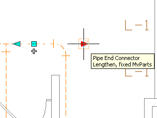

The following example illustrates how a plumbing line segment in a vent system is lengthened. To avoid interference with a duct system, the software adjusts connected objects to maintain their connectivity.
Plumbing line segment selected
Lengthen grip selected
New length specified
Resulting layout
