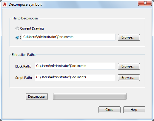

To convert a set of device styles to their individual blocks
| If you want to… | then… |
| convert the device styles in the current drawing open in AutoCAD MEP 2021 toolset | click Current Drawing. |
| convert the device styles in a drawing stored locally on your computer | click the radio button beside the file path, click Browse, select the drawing file, and click Open. |
If the selected folder already contains drawings, then during the conversion process, you will be prompted about overwriting drawings with the same name.
| create a new script | in the Select File dialog box, specify the location for the new script, enter a name, and click Save. |
| overwrite the contents of an existing script | in the Select File dialog box, select the drawing, click Save, and then click Yes to confirm that the contents of the drawing can be overwritten. |
The software converts the device styles into the blocks used by the style views and generates an associated script based on the style definitions.
