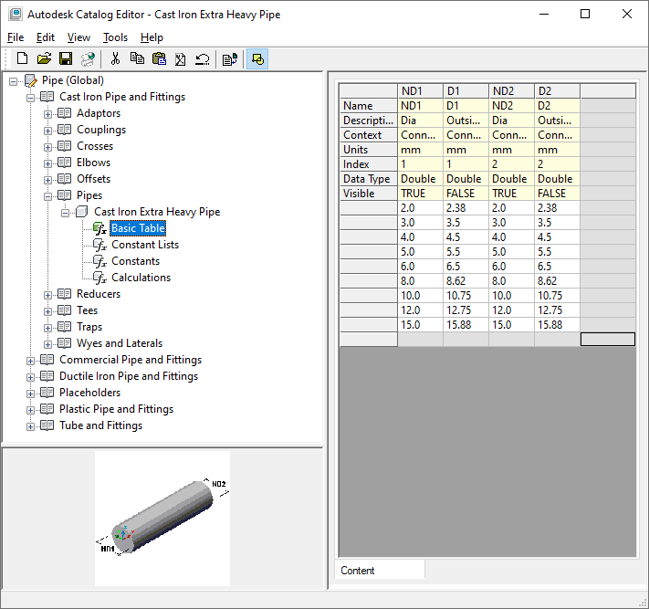

Pipe parts catalogs are organized differently, depending on the profile in which you run AutoCAD MEP 2021 toolset. Catalogs in the US Imperial and US Metric profiles are organized based on material type:
Fittings in these categories are grouped by connection type (such as threaded). The following example shows the cast iron parts catalog.
Pipe parts catalog for cast iron pipe parts

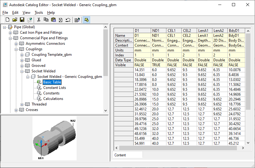

Each pipe directory in the Global profile consists of fittings common to that pipe type. Pipe fittings are typically classified by part type, connection type, and pressure rating. The next example shows a directory structure for a class 3000 socket weld coupling.
Couplings under Pipe catalog
