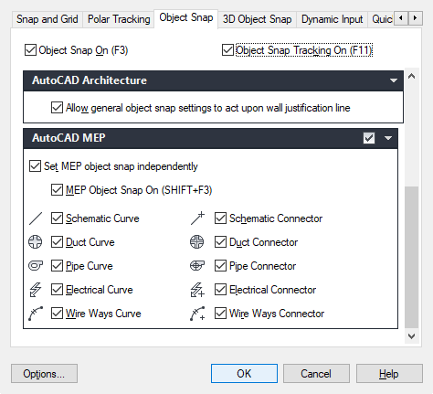

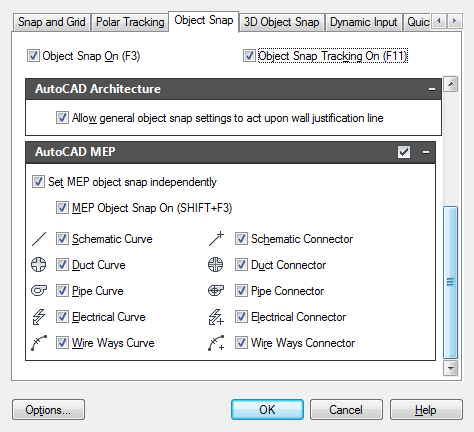

  1. On the application status bar, right-click (object snap), then choose Settings.
  2. In the Drafting Settings dialog box, click the Object Snap tab, and then scroll down to AutoCAD MEP 2021 toolset.
  3. Click to select the snaps you want to activate. You can also click the check box to the right of the AutoCAD MEP 2021 toolset title bar to select all the snaps at one time. Click the check box again to clear all the AutoCAD MEP 2021 toolset snap selections.
    Tip: As a shortcut, press Shift-F3 to toggle AutoCAD MEP 2021 toolset snaps on or off.
