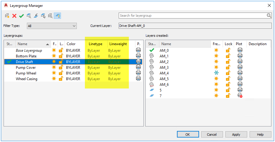

AMLGLTMODE Makes the Layergroup Linetype available for editing.
AMLGLWMODE Makes the Layergroup Lineweight property available for editing.
Enhancements to Layergroup Manager and Mechanical Layer Manager
In the Layergroup Manager, you can now specify the layergroup linetype and lineweight, just like how you specify the layergroup color.

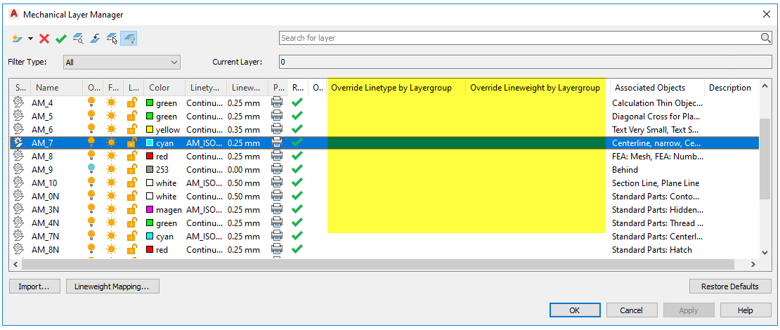

In the Mechanical Layer Manager you can choose to override the layer linetype and lineweight with that of the layergroup.

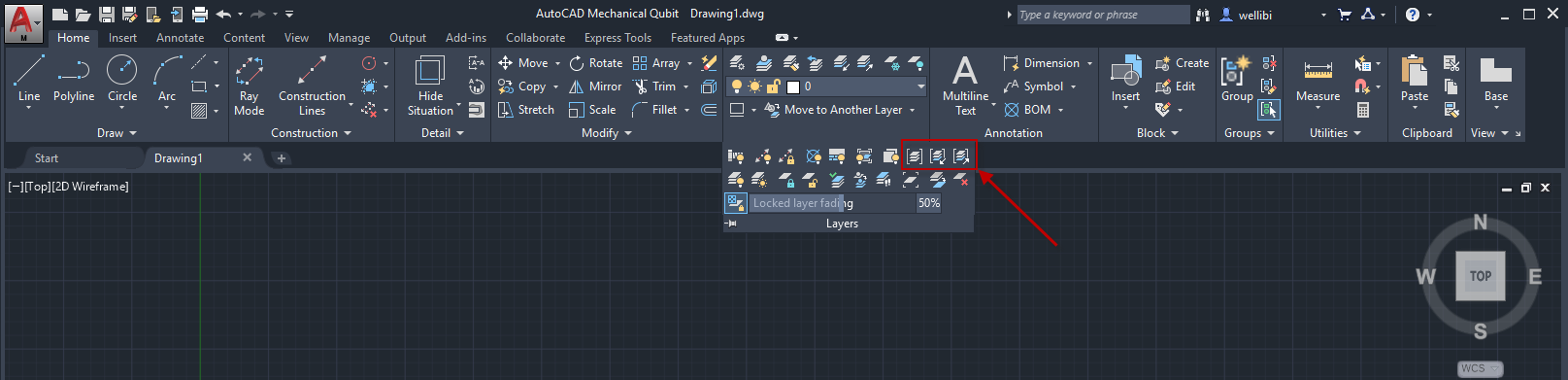

Enhancements to Ribbon
Layergroup tools such as the Layergroup Manager, and the AMLGISO and AMLGUNISO commands, are now available on the Layer panel of the Home tab.
