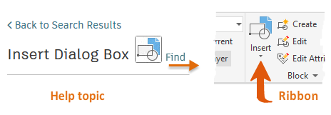

Help System
The UI Finder was added to most dialog box topics. This makes it faster to locate the command associated with the dialog box in the UI. Simply click the command icon at the top of a dialog box topic in the Help system to locate the originating command. For example, you can find the location of the INSERT command from the Insert Dialog box topic.
