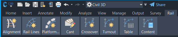

Where is it located?
Rail design tools can be found on the Rail ribbon tab. Hover over one of the rail design buttons to show a drop-down menu with the options to create, edit, and delete the respective rail element.
