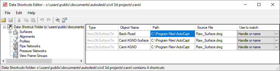

In the data shortcut editor, the data tree on the left shows all the data shortcuts in the selected project folder. To select a different folder, click File menu Open Data Shortcuts Folder.
The table grid on the right shows the properties of each data shortcut. You can change the object name or path for each shortcut, and you can specify whether to use the handle (software ID) or name of the source object to create a match with the data shortcut.
The Data Shortcuts Editor window

On the Edit menu in the Data Shortcut Editor, use the Find and Replace command to quickly change text strings in the names of data shortcuts, paths, or source drawings.
In the shortcut table, set the Use to Match column to associate data shortcuts with their source objects by means of the source object’s name or handle, or both. The object’s handle is its unique identifier used by the system. Users cannot change the handle, so it can be the most reliable matching attribute if an object’s name has changed.
One situation in which you would match by name is if you delete an object, then re-create it and apply the same name. The new object has a different handle, but if you use the match-by-name option, the old data shortcuts will automatically reference the new object.

  3. In the Data Shortcuts Editor window, click File menu Open Data Shortcuts Folder, and navigate to the project folder that contains the data shortcuts you want to edit.
The data shortcuts are displayed in a table grid.
