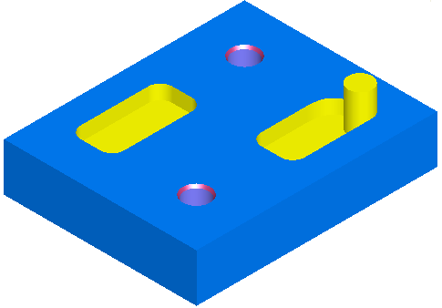

To view the simulated toolpath:
- Click Home tab > Simulation panel > Sim Mode > 3D to change the simulation type.
- Click
Play
on the Simulation toolbar to start the simulation.
If the
Ordering dialog is displayed, click
OK to close it.
This displays a solid 3D rendering of the cutting process.
Note: If all tools are displayed in gray in the simulation, enable the File > Options > Simulation page > Tool Colors option to see which features are machined by each tool.
