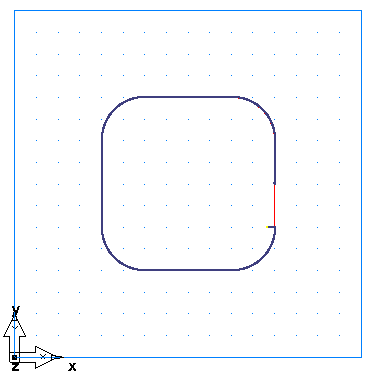

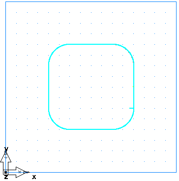

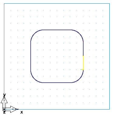

To view the simulated toolpath:
- Click Home tab > Simulation panel > Sim mode menu > 2D to change the simulation type.
- Center the Simulation Speed slider
to specify the simulation rate.
- Click
Play to Next Operation
to see the retract operation.
Note: To slow down the simulation, drag the
Simulation Speed
slider to the left.
- Click the
button again to see the cutoff operation.
- Click the
button again to see the final contour operation.
- Click
Stop
to end the simulation.
