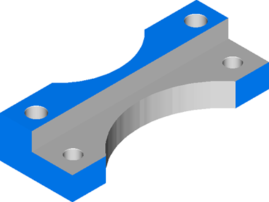

Run a 3D simulation to see if the features have been created correctly and to check for gouges.
  1. Click Home tab > Simulation panel > Sim mode menu > 3D to change the simulation type.
  2. Click Play on the Simulation toolbar to start the simulation.
    The 3D cutting simulation is displayed in the graphics window.
