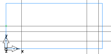

  1. Create three vertical lines:
    1. Click Construct tab > Geometry panel > Line menu > 2 Points.
      The Feature/Geometry Edit bar is displayed.
    2. In the Feature/Geometry Edit bar, enter an XYZ of X 1, Z 0, and press Enter.
    3. Create a second line by entering an XYZ of X 5.25, Z 0, and press Enter.
    4. Create a third line by entering an XYZ of X 6, Z 0, and press Enter.

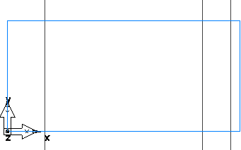

  2. Create three horizontal lines:
    1. Click Construct tab > Geometry panel > Line menu > Horizontal.
    2. Enter an XYZ of Y 0.5, Z 0, and press Enter.
    3. Create a second line by entering an XYZ of Y 1.125, Z 0, and press Enter.
    4. Create a third line by entering an XYZ of Y 1.5, Z 0, and press Enter.

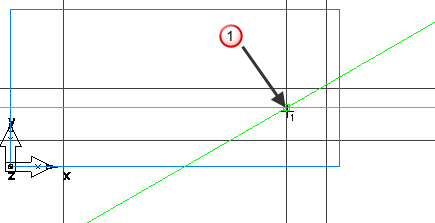

  3. Create a through line:
    1. Click Construct tab > Geometry panel > Line menu > Point, Angle.
    2. In the Feature/Geometry Edit bar, enter an angle A of 30.
    3. In the graphics window, click at the intersection between the second horizontal and second vertical lines, at point, to create a through line.

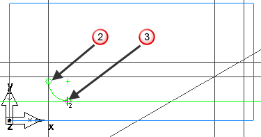

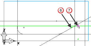

  4. Create arcs.
    1. Click Construct tab > Geometry panel > Arc menu > 2 Points, Radius.
    2. In the Feature/Geometry Edit bar, enter a radius R of 0.5, and click the vertical line around point and the horizontal line around point.

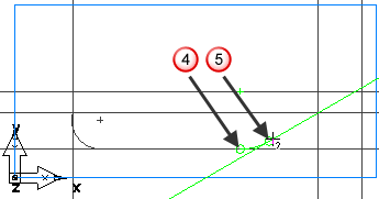

    3. Create the second arc:
      In the Feature/Geometry Edit bar, enter a radius R of 1.0, and click the horizontal line around point and the through line around point .
    4. Create the third arc by clicking the through line around point and the horizontal line around point .

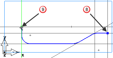

  5. To mill the part you need to chain the curves.
    1. Select Home tab > Create panel > Chaining > Pick Pieces.
    2. Click at the intersection of the vertical and horizontal line at point and at the intersection of the vertical and horizontal line at point .
