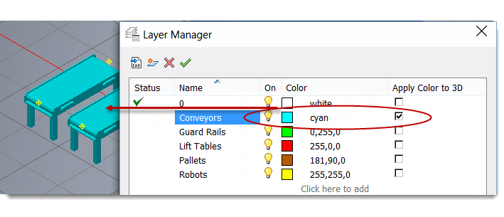

Assign a color to a layer
A newly created layer is white by default. You can assign a unique color to a new layer by doing the following:
  1. Click the color swatch to the right of the new layer name , or click the word 'white'. The Color dialog displays.
  2. Select one of the basic colors, or create a custom color from the color palette at the right of the dialog.
  3. Click OK to close the Color dialog. The color you selected is assigned to the new layer.
Use this same procedure if you want to change an existing layer to a different color.
Note: Remember that layer colors only appear in AutoCAD Factory after using the Open in AutoCAD command. White assets display as black on a light AutoCAD background, and display white on a dark background.
Apply layer color to assets
Select Apply Color to 3D to apply the corresponding layer color to the assets within that layer for easy identification.
Leaving this option unchecked retains the original asset colors regardless of layer color.

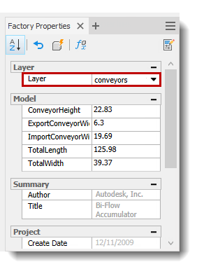

The second method involves using the Factory Properties browser.
  1. Select one or more assets from the factory floor layout. Press and hold the Ctrl or Shift key for multiple selections. The layer name of the selected asset appears near the top of the Factory Properties browser. If multiple assets on different layers are selected, the layer name appears as *VARIES*.
  1. Click the down-arrow to the right of the layer name to display a drop-down list containing the names of all the layers defined in the current layout.
  2. Select the layer to which you want to move the selected asset(s). The drop-down list closes and the layer you selected replaces the previous layer name.
  3. Click the Update button in the Factory Properties toolbar to move the asset(s) to the different layer.
