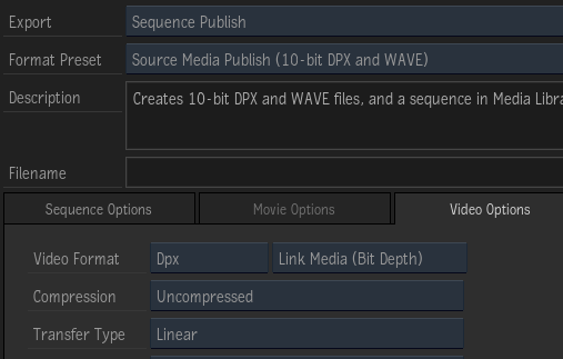

When you export a clip as a file sequence (using the Video Options), or when you export it as part of a Sequence Publish where the media is exported as a file sequence, you can use the Link Media options to accelerate the export and minimize used storage space.
Because unedited frames are not recreated but only referenced in the exported sequence, the export takes less time to complete, and saves storage space by avoiding media duplication. The mechanism used to create links is described at How Media Linking Works.
Link Media Export Options
Simple Link Media (Bit Depth) example:
The last 40 files are referenced, and because they were neither created nor moved, the export process was that much faster.
