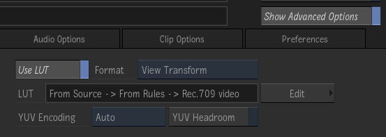

LUT Activation button
Enable to apply the LUT or colour transform displayed in the Applied LUT field to the clip.
Format box
When Importing: Select Colour Transform unless you're applying a legacy format 1D or 3D LUT. When Exporting: View Transform applies viewport colour management to the export; Input Transform applies import colour management (or its inverse) to the export; Colour Transform is for CTF and most other formats except a legacy 1D or 3D LUT; Tag Only overrides the colour space written to an OpenClip XML file.
Applied LUT field
Displays the type of conversion LUT applied to the clip, either imported using Import, or edited using Edit.
Colour Management Access button
Click to configure colour management settings.
Include YUV Headroom button
Enable to include the YUV headroom in the exported media files, creating a full-range clip. Disable to convert your clip into a legal range/valid colour clip, with values between Reference Black and Reference White. Leave disabled when the deliverable is broadcast, and enabled when you want to provide wider range for post-production processes like grading and visual effects work. Automatically disabled when exporting using a QuickTime RGB codecs.
YUV Encoding box
Select the clip's YCbCr colour encoding matrix. The application uses this to translate native RGB values into YUV ones. The Auto setting selects the colour encoder based on the resolution of the clip: Rec. 601 for clips with a resolution lower than 720 lines, Rec. 709 for everything else.
Flame works in an RGB colour space: it needs to translate RGB information back into YUV. This setting ensures that the right encoder is used for this. Specifying the wrong option will result in colour problems upon decoding. Per Recommendation BT. 2020, UHD media should use the Rec. 2020 colour space. But this is rarely the case at the moment: UHD clips still use Rec. 709. The Rec. 2020 option is there is case you need the new standard.
See also: Applying Colour Management to Clips
Format box
Select View Transform to apply viewport colour management to the export. Select Input Transform to apply import colour management (or its inverse) to the export. Select Colour Transform for CTF and most other formats except a legacy 1D or 3D LUT. Select Tag Only if you want to override the colour space written to an OpenClip XML file.
Applied LUT field
Displays the type of colour management applied to the clip, either imported using Import, or edited using Edit.
Import button
Use to browse and select a colour transform.
Click to open the Colour Management editor.
