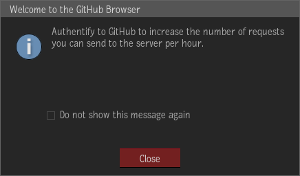

Authenticate into GitHub to Increase the Number of Requests
Chances are that the first time you try to add a custom action from GitHub you will get the following message.
The maximum number of requests made to the repository is set to 60 per hour for users not signed in a GitHub account. This number increases to 5000 for users that are signed in.
To sign in a GitHub account from Flame you must:
- Create a GitHub account at
www.github.com.
- Generate a token using the following procedure:
Creating a personal access token
- In Flame, access the
Add Action to Context Menus browser and click
Log In.
- Enter your token in the GitHub Authentication window.
