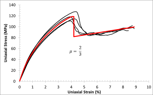

Earlier we saw experimental data showing how the material exhibits a load drop under compression. Let's call the magnitude of this load drop μ. The value of μ varies as the loading angle changes. Therefore, we need a method to determine μ for any stress state that triggers the compressive failure criterion.

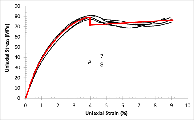

0
90°:
90

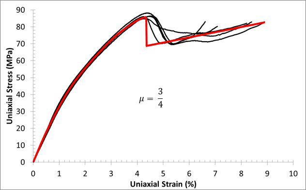

45°:
45

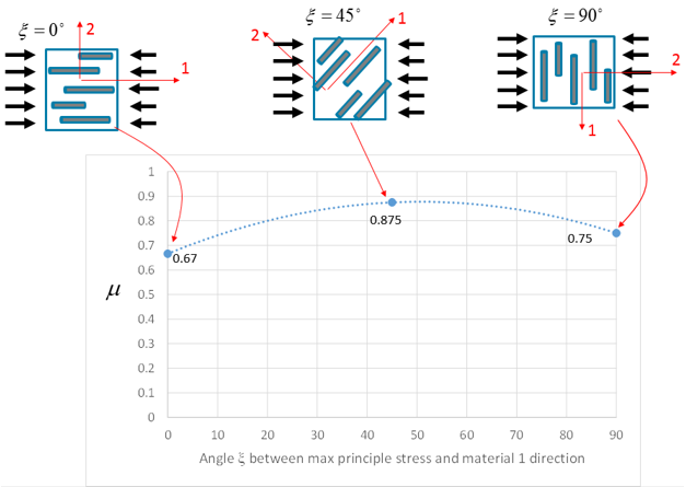

The image below shows an example of how μ is dependent on the direction of the principal compressive stress relative to the principal fiber orientation.
mu vs xi
