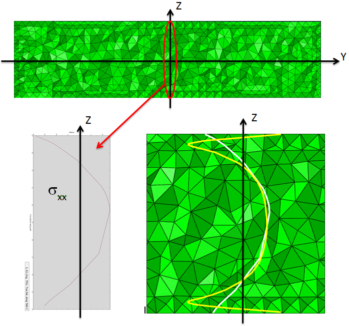

At this point, we can evaluate the post-warpage stress field as predicted by the Helius PFA solver and compare to the traditional stress fields published in academic research papers. The image below shows the through-thickness stress field for a rectangular shaped coupon produced by injection molding [15].
distrbn paper
To compare the stress fields, we created a similar rectangular shaped part and examined the stress distribution in the flow direction as predicted by Helius PFA using the non-mechanical strains from Moldflow. The image below shows a cross-section of the part and the predicted stress field. The image in the lower right depicts the superimposed curve produced by Zheng [15] shown in yellow, and the curve predicted by Helius PFA shown in white. These curves represent stress field for the unconstrained, warped part, with no external loading.
cross section
In the simulated results we notice the core of the part is in tension and the surface is in compression. This behavior correlates well with the academic research. Given the mesh density used in this example, it is impossible to capture the sign reversal predicted by Zheng in the outermost portion of the part. However, this method does a good job of representing the compressive strain energy in the outer fourth of the part.
