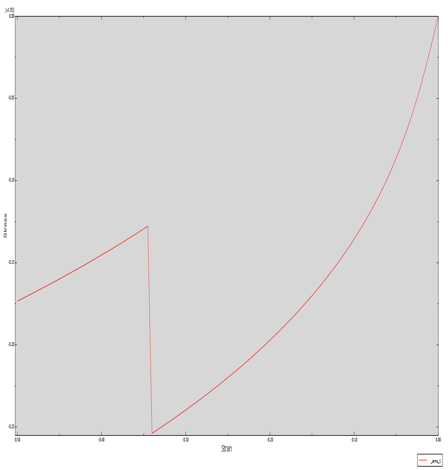

To understand the impact the *COMPRESSION keyword can have, let's take a look at the following examples. In the first example, the default compressive behavior is used.
*MATERIAL, NAME=CA-PLASTIC-1
*COMPRESSION, FAILURE=ON, NONLINEAR=ON
If we create a stress-strain plot for a model under a compressive load, we see a very typical response. Plasticity continues to accumulate as more and more load is applied. At some point, the structure fails and we see a stress drop. After the large stress drop, the model is able to reload due to the physical interference of the failed material.
reload

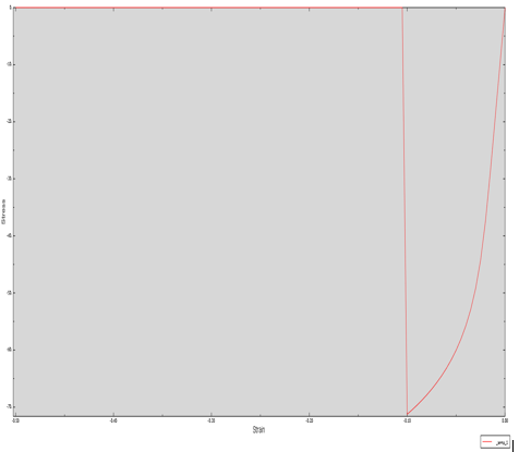

In the second example, the nonlinearity is turned off. As a result, the tensile plasticity and rupture models are used.
*COMPRESSION, FAILURE=ON, NONLINEAR=OFF
The stress-strain curve now exhibits a response typical of a tensile failure. Plasticity continues to accumulate once again, but when the ultimate failure of the structure occurs, the composite stiffness is reduced to a very small number (1E-06 by default). This is evident in the large stress drop.
no reload
