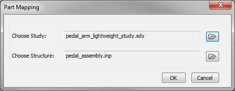

  1. Click part map icon (Start & Learn > Information Pairing > Part Mapping).
  2. When the Part Mapping dialog appears, select the study file to be paired. Once selected, you will see a preview of your model that you can use to verify the correct model was selected. If it is the correct model, click OK.
  3. Select the structural input file to be paired. Now you will see a preview of your structural model. If you selected a single part model, you can skip to Step 4. If you selected an assembly model, you must identify the first part you want to pair with the Moldflow study. To do this, either select the body or the body name from the preview window.
  4. Select the unit system used to define your structural model and click OK.
    Note: Structural models created in ANSYS Workbench or Inventor Nastran In-CAD will have the units automatically detected.
  5. Click OK to complete the part pairing.
    part map dialog
