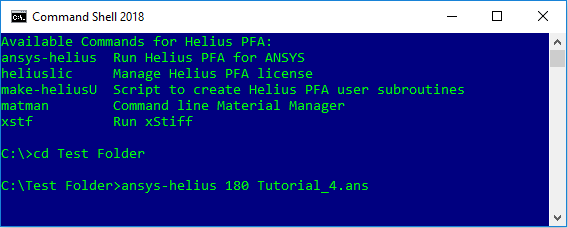

  2. Change the directory to the location of the input file by entering:
    cd [directory address]
    As an example, if the input file is located in "C:\Test Folder", enter "cd C:\Test Folder" as shown below.
  3. Submit the job by entering the following command as shown below:
    ansys-helius 211 Tutorial_4.ans
    In the above, ansys-helius calls the batch file that submits jobs using the custom ANSYS executable, 211 is the version of ANSYS (201 and 202 are the other valid options), and Tutorial_4.ans is the name of the input file.
