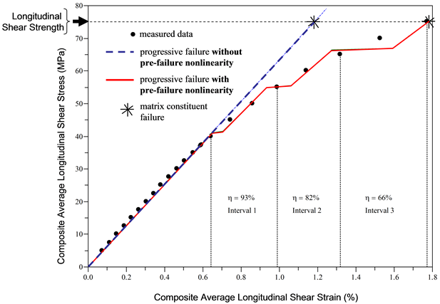

The plot below shows a typical measured longitudinal stress/strain curve for a unidirectional carbon/epoxy lamina. The pre-failure nonlinearity feature approximates this type of nonlinear longitudinal shear response with a four-segment, piecewise linear representation.
We could create a similar plot for woven composite materials. In this case, rather than three discrete reductions in the longitudinal shear stiffness, we would see six discrete reductions that result in a seven-segment piecewise linear representation of the longitudinal shear response.
