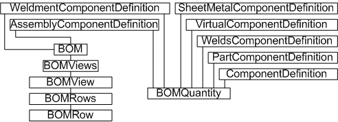

BOM Object Model Diagram

Autodesk Inventor maintains the BOM internally, updating types and quantities as changes are made to an assembly. These changes may be implemented through the user interface or through the modeling functions of the Autodesk Inventor API. The BOM API can make additional changes to the BOM data, and can query and export that data. Autodesk Inventor makes use of PropertySet objects to store some BOM data for a component. Client code can access this data directly.
